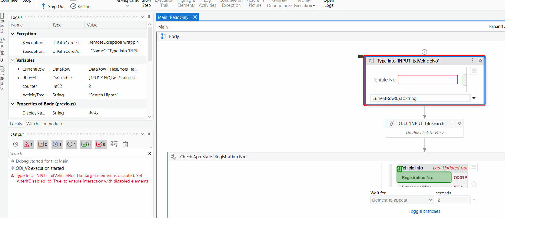

Automation stops after few instance of click with attached error

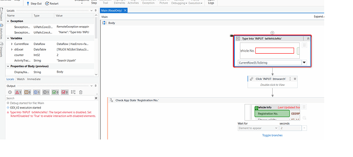

Hello Team, Just need some suggestion. In below images it says target element is disabled. Manually need to click reset button available on screen and enable again.
Is there anyway if its disabled, we can click on reset button again to enable this and continue the next flow? Any suggestion will be helpful.

use “Get Attribute” activity to fetch the status of the text box followed by if condition to perform the action based on the status of the textbox.
hi,
–In type into activity in properties set “Alterlfdisabled” as a TRUE
