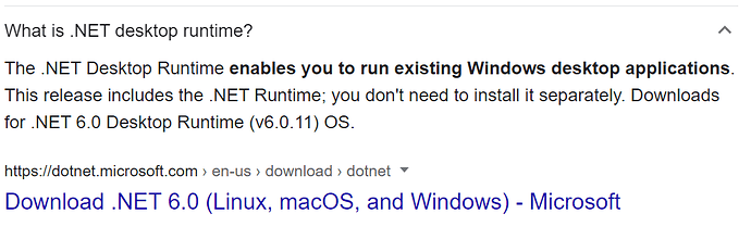

Hello @ivette_lugo ,
Please check this post. It has the same error:
I’m afraid you must you have to remove .net desktop runtime, restart your machine, and install the latest available .net desktop runtime
Best regards,
Marius
Thanks so much, it worked!!! Thank you, thank you, thank you.
