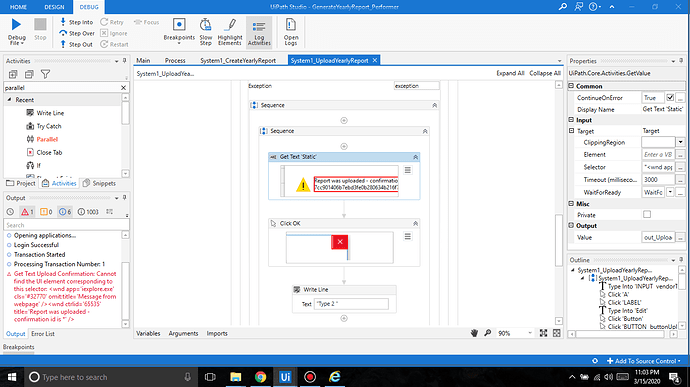

Please use debugging, to get exactly where it stops… Let me know what’s the exact error, you getting…
Every time I get to this point
and then it stops and I get this kind of error. If I hit continue it moves forward properly but I’m trying to find a way to avoid the error and for it to move smoothly.
Follow above solution ![]()
