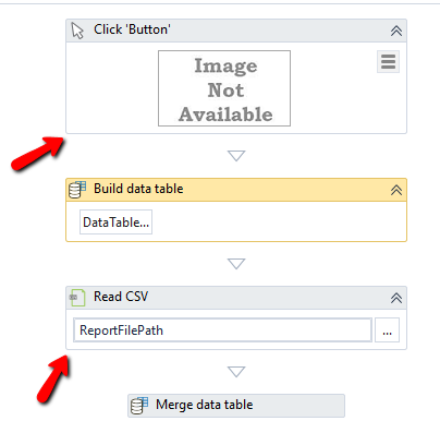

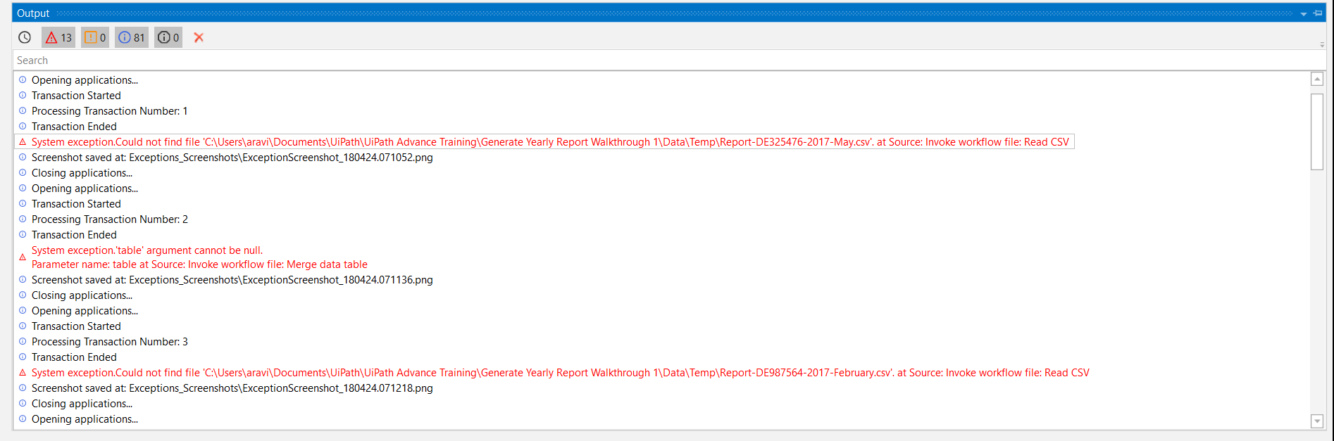

I get an error in Create Yearly Report Workflow after download the yearly report and read “.csv” file it showing error on that kindly help me out of this find the error Screenshot and XAML file., Thanks in advance
I would suggest verifying that the file is being downloaded to that location. And if it is, watch for how long it takes to download if it’s a timing issue. (Using a Retry Scope with a File Exists activity in the condition is a good way to wait for files to exist).
Verify these things manually first to rule out coding mistakes.
Thanks for the reply @ClaytonM I had rectified the issue by using delay activity before reading csv activity and I skipped element exists for download notification it’s working fine now.,
