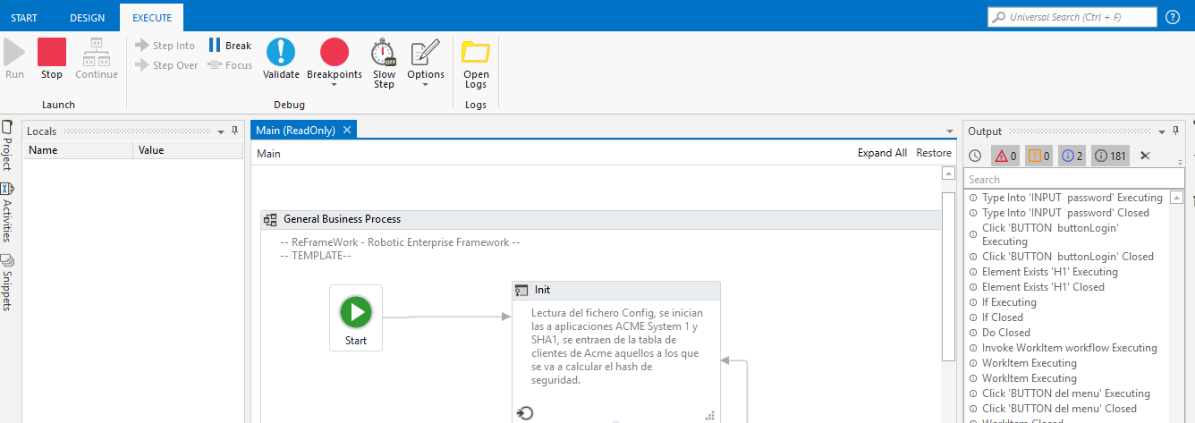

he doesn’t show me anything either
did you check the “Local” tab when it hits the error?
Please, where?
I am trying to check the value of the WIID variable either after the assignment or in the System1_NavigateTo_Details workflow.
What sentence should I use?
I need to know what content this field has because the process stops in “Client Information Details”

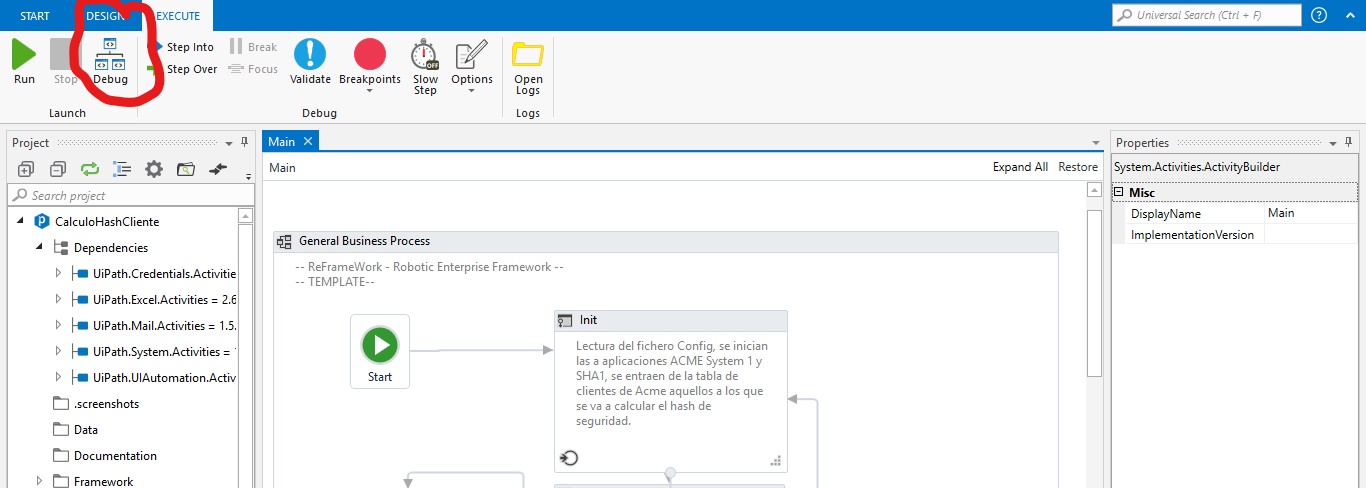

u run ur program in debug, see ur left panel, find a tab called local
Yes, there is the panel but I don’t see the value of any variable.

set a breakpoint at whereever you think there are errors. then run in debug mode and wait till ur program hits the breakpoint
URL
Execution does not stop
