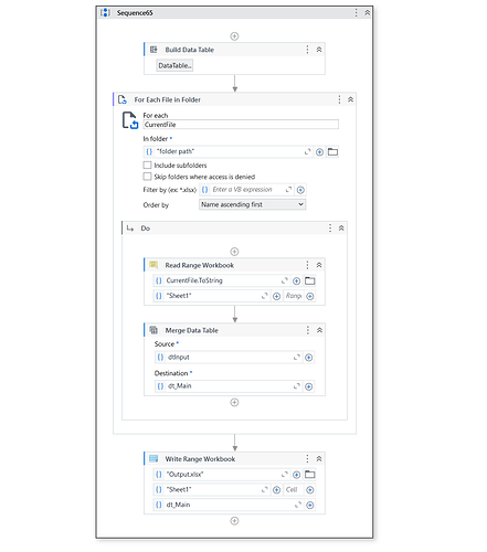

Hi @yogitagaikwad2206
Check the below workflow:
Sequence65.xaml (11.1 KB)
Hope it helps!!

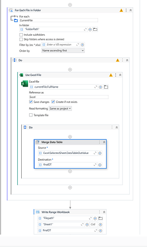

Can you try the below
Main.xaml (18.1 KB)
@yogitagaikwad2206
Follow the steps
  1. For each file in folder
  2. Use excel file - currentfile.FullName
  3. Inside that use merge datatable activity with destination as FinalDT and source as Excel.SelectedSheet.DataTableOutValue
  4. After then loop use write range workbook and write the finaldt to the file you need
Hope this helps
cheers

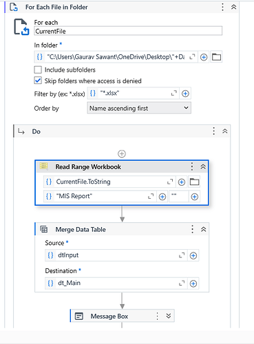

This is my workflow plz tell me how append all excel data into one excel sheet

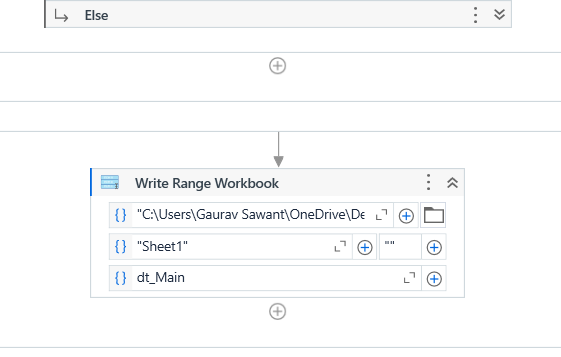

can u tell me why this error is come
This is my workflow
Please remove the double quotes in Range of Read Range Workbook and run the flow @yogitagaikwad2206
Regards
again this error is come can u tell me why u take build data table?
Build Data Table is taken because since you need to append it to single data table and write it to an excel. Everytime you read the excel and merge it, every excel data get merged to a single Dt. I hope you have same columns in all the excels.

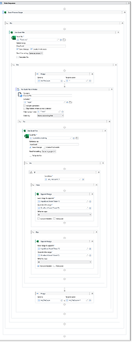

Can you try the below flow:
Workflow.xaml (21.2 KB)
