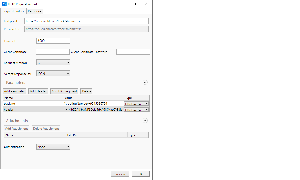

hi. i have the following API instruction together with the API keys. But after i enter all these information in the HTTPRequest. It return authorisation error. can anybody advise how do i fill in all these parameter in the UIPATH

Hi @limcheehang
You want to use the key value pairs in those fields, like so:
Also, note that one is a parameter value and the other a header value.
