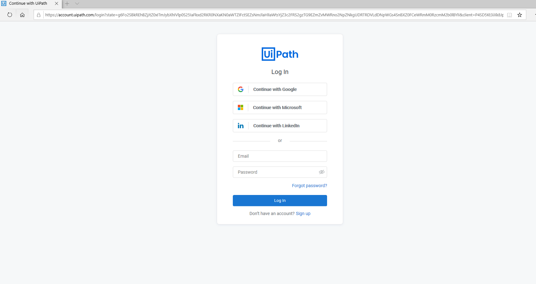

  1. Open the UI Path Account Login page using
  2. I cannot use the Email and password option as it gives invalid email/pwd error. I think this is because I am registered with SSO on microsoft.

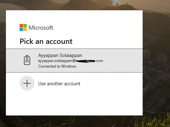

  3. I click on the continue with microsoft option and get the below.
    It picks up the creds automatically because I am connected to Windows.
