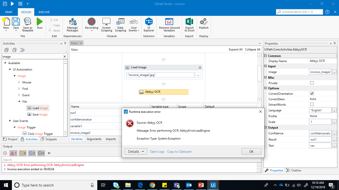

I’m doing a POC on invoice processing using abbyy fc 12. But when I used the abbyy ocr activity I’m getting the following error. Can anyone please help me in this? Also If possible can you give me a sample workflow for data extraction using abbyy?? I have attached the screenshot of the error below:

Please share sequence screenshot where you try to use abby ocr.
Naitik
Im curious as to what you have set for image input?
have you loaded this image then assigned it to your variable and then passing it to the AbbyyOCR input?

@nadim.warsi Please see the screenshot
