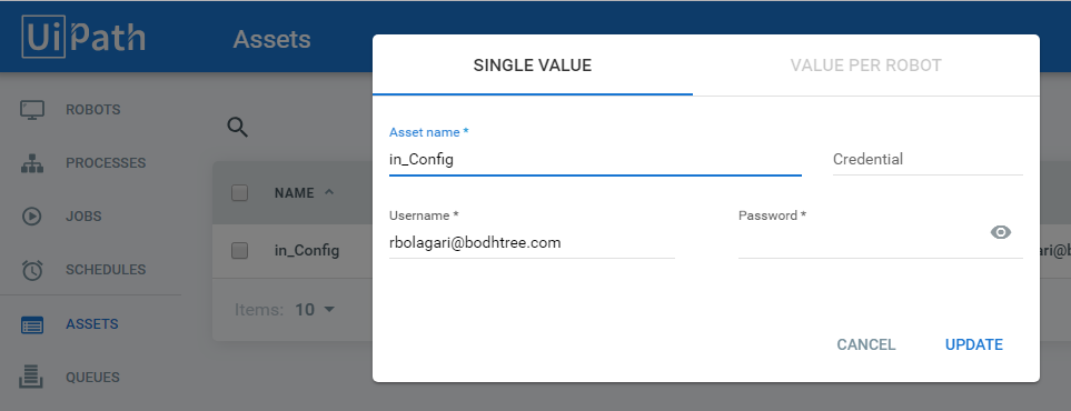

in above screenshot (Before one) Asset Name is System1_Credentials so assign it in value part.

Loading asset in_Credential failed: Could not find an asset with this name. Error code: 1002

she changed use hardcode “In_Config” instead of Config Object.

Could you screen shoot the asset list on your Orchestrator.
