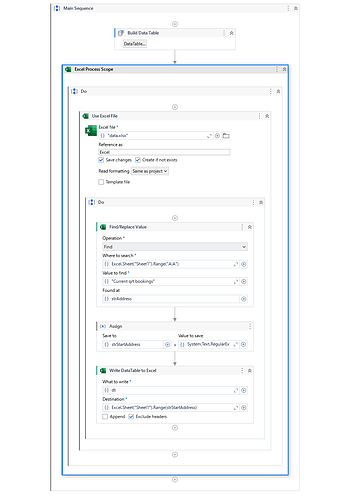

Can you try the following sample?
First, find cell address of “Current qrt bookings” using Find/ReplaceValue activity.
Then calculate start address of the table from the above address (row number + 2)
strStartAddress = System.Text.RegularExpressions.Regex.Match(strAddress,"[A-Z]+").Value+(CInt(System.Text.RegularExpressions.Regex.Match(strAddress,"\d+").Value)+2).ToString
Finally, write datatable without header from it.
Sample
Sample20231129-1.zip (9.5 KB)
