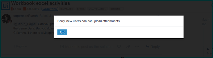

I am not allowed to attach the input excel file.

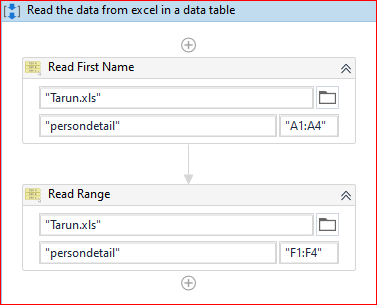

@Tarun_Bajpai Check this Workflow :
CombineColumnValues.zip (10.7 KB)
This will give the output you need when you have the same number of records in each Sheet. Also this is not a very good approach, but we can work on the other approach if you can give me an expected Output for other type of cases involved.
