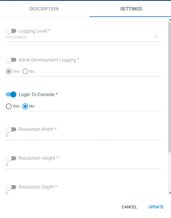

I tried changing the uipath.setting file and restarting UIRobot again. still it doesn’t work. Is there any other solution which can prevent getting kicked out of the VM
I am facing the same problem. In my case I am using only 1 BOT.
Are there any setting in VM that needed to be checked ?
You might forgot to check your Robot Settings in Orchestrator itself. To do that, log in to your Orchestrator, > Robots > Select the Robot > Edit > Go to Tab Settings > Turn on the "Login to Console and Make it Off.
That worked for me. Thanks
