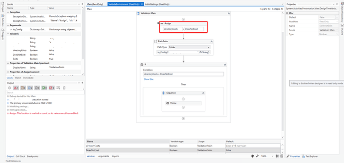

I noticed that I am also having problems when I try to use it on assignment to local variables. Why can I not set the initial value of a non-Read-Only local variable to a read only variable?
snip_readonly_var2
snip_readonly_var4
snip_readonly_var3

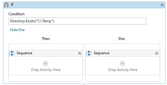

Directory.Exists() returns boolean, so you can just do…

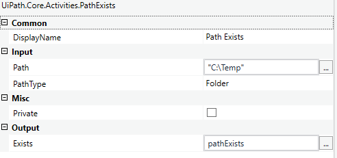

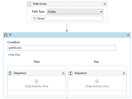

If for some reason you want to use the Path Exists activity, the result is that its output variable (pathExists, or whatever you named it) has a value of true or false, so you can just do…
Again, though, that’s extra work because you’re creating variables and splitting it into multiple steps/activities, when you can just directly use the Directory.Exists() method in one step.

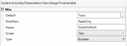

The variable DoesNotExist is intended to act as a constant that avoids “Imaginary Boolean” values. So there is not a question on what the boolean value False actually represents. By setting it to a constant, the constant describes False.
The Path Exists activity could be removed entirely, as you recommend, as it does not seem too cluttered. I would probably want to put the string path in a constant variable to avoid a magic string.
The single variable conditions on the Boolean seem appropriate to me, however, I’ve seen single variable Boolean values that did not adequately describe the condition. When applied with constants they add additional context to the condition.
I appreciate the possible clean up of code, however, I’m still inquiring about the Read-Only variables being assigned to non-Read-Only variables.

A constant named DoesNotExist doesn’t actually tell us anything. It doesn’t even indicate that it’s a boolean.
Sorry for the delay. The ValidateEnvironment workflow highlight above is using the DoesNoteExist read-only variable to initialize the non-read-only variable directoryExists. Also, I wasn’t stating that the read-only variable cannot be used for initialization as fact, but only that it cannot in my current configuration.

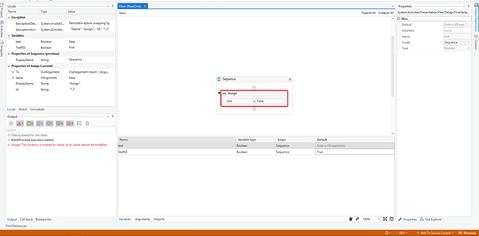

Based on above, it doesn’t matter if the project is using the RE Framework or not. A simple project (Compatibility = Windows; Language = VB) with a single process will produce the exception for me. I did a few more tests.
  • When the project was first created, I added a sequence to the main process. I defined a read only variable in the scope of the sequence, and ran the project. No exception was thrown.
  • I added a single WriteLine activity, with the text “test”, into the sequence. No exception was thrown.

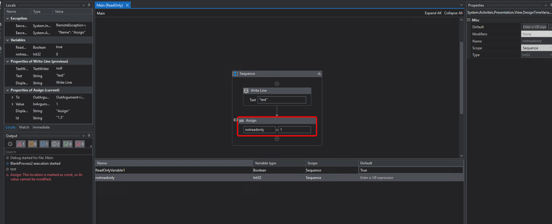

  • I then added an assign activity after the WriteLine activity. I tried to assign a string variable the value of “test”. The exception was thrown.
I captured a few more, possibly relevant snippets.

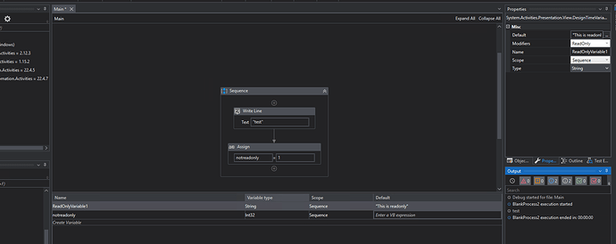

I found that if only string constants are used in the process, this issue does not popup. As soon as a Boolean constant or Int32 constant is defined, the error is trigger.
An additional test, and snip.
  1. I added a sequence to a blank process. On the variables panel, I created a ReadOnly Boolean variable with a value of True.
  2. I ran the process, no issues.
  3. I added a WriteLine Activity with “test” for text
  4. I ran the process, no issues.
  5. I added a new variable of type Int32 with no default value that is not ReadOnly to the variables panel.
  6. I ran the process, no issues.
  7. I added an assign activity to the sequence. In the assign sequence, I assign the Non-ReadOnly variable the number 1.
  8. I ran the process, the error is thrown
  9. I changed the ReadOnly Boolean variable in step 1 to type String, and gave it text, “This is readonly”.
  10. I ran the process, no issues.
Step 8
Step 10 - (Notice the output panel)
