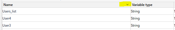

Judging by your last image, the error is definitely occurring at the declaration of Arguments and Variables in your outermost sequence. I would suggest selecting the sequence and looking in those sections for any variables used inside of other variables; if it tries to declare using another variable that has not been declared yet, then you will have this issue. Note: it declares in this order: Arguments top to bottom, then Variables by scope top to bottom (and by top to bottom I mean in the order the variable was created)
Oh also, if you use an IN argument as a DataTable, try adding new DataTable in the Default value
Hi @Akanksha_Varshney
@ClaytonM is onto something, see below how I recreated your issue:
Funny enough, to fix this particular case you have to not only initialize your array with some content, but also make sure it happens before you will use that array to initialize another variable (in practice, switch places of the variables, so that the array is initialized first, before the Join method is run using it)
Please check your variables to see for similar scenario.

It seems like the variable order behaviour is a direct result of the order of variables in the XAML file. It is basically reading it from top to bottom, and this is the result.
It seems we have to watch out for the order then. To be sure that it is correct, it might be better to initialize your variables in directly in the workflow (this would allow you to easier predict the behaviour).
