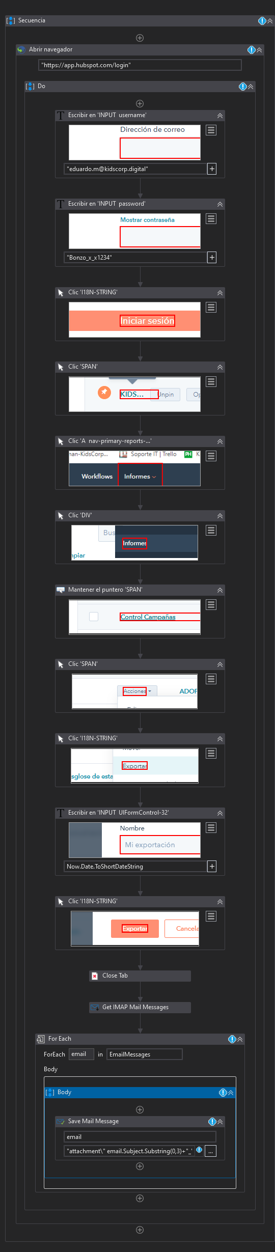

I will be taking a look at the articule you mentioned , in the meantime , here´s my flow :

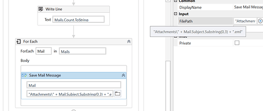

@Eduardo_Martinez - Can you try this…
Reason why I used substring (0,3) is : some email contains , : " characters which is not supported in the folder path. So you will get an error…

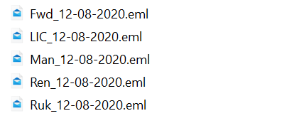

Output
Output:

You want something like this…
Code: “Attachments" + Mail.Subject.Substring(0,3) +”_“+ datetime.now.ToString(“MM-dd-yyyy”)+”.eml"

@Eduardo_Martinez - you are missing the double quotes…
Please look refer my code…
Here is Attachments is the folder name…This will create folder Attachements folder inside you Uipath Project Folder(where your xaml file is)…
Please try to copy as is first…once worked you can make modification…

I copied the information using the shared code (your image) the only detail I had to change was : your mail variable on my end is email and in your case the attachment folder was named with capital letter A and on my end I used all lower , never the less I´m still getting an error. Here´s my info
My error states the following :
Error ERROR Validation Error Compiler error(s) encountered processing expression ““attachment" email.Subject.Substring(0,3)+”_” + DateTime.Now.ToString(“MM-dd-yyyy”)+“.eml”".
AN END/FINISH EXPRESSION WAS AMain.xaml (22.3 KB) WAITED
