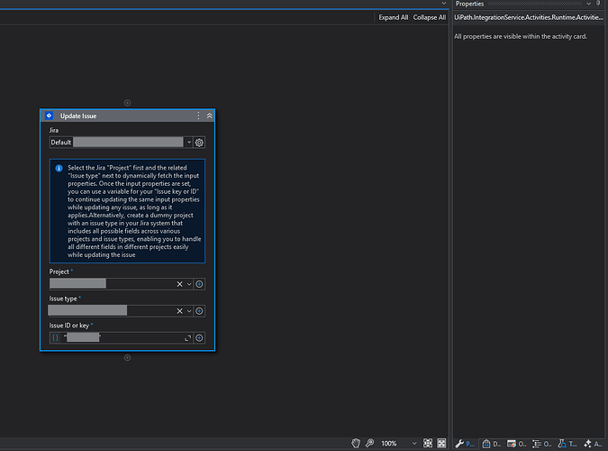

"Update issue" can't load issue properties. Jira Integration Service
A few days ago I tried to update jira issue using Integration Service. I used it before and it worked well, but now I can’t get dropdown and select issue to load properties. I tried to reconnect my integration, checked all permissions, but everything looks fine, some activities like “Update issue status” shows all dropdowns and I can use it as well.
Also I deleted cashe and tried another PC and got the same issue. Package downgrading does not help too.
I use the lastest package 1.17.0 and studio 2024.10.16.
If anyone has encountered this issue, please share your exerience on how to deal with it or maybe how to load properties without jira issue selecting

Hi!
Thank you for quik response.
I’ve already tried everything you suggested, except for manually entering the fields, I can’t find a button that would open the properties for me.
We exclude access issues, since some activities work properly with the same jira issues and pull up all the necessary dropdowns. Additionally, the admin and I have checked everything we could on our side.
There is also a ticket, but we haven’t been able to find a solution in a few days so I decided to create a topic here to.

Thanks for the advice. I tried using this activity in Studio Web and it behaves similarly to the desktop version, so I can try to get data from there. For security reasons, Fiddler is not desirable for me, so this will be a last resort.
I know about the deprecation of the GET request on the Atlassian side, which roughly coincides with the appearance of problems in my projects, but I’m a little surprised that there are no such fresh topics in the community and some activities continue to work even with this, so I’m not entirely sure what the reason is

Edit, mine looks similar to yours, and all my dropdowns are loading, but I think I slightly misunderstood your issue.
I think I see the problem. We have an ‘Update Issue’ activity, but then it gives you no options for updating that activity :upside_down_face:
I’ll run Fiddler and see if I see anything, but this looks like a global issue, not local to you.
Ooof, this is a nasty one.
So the Create Issue works totally fine for me and loads the properties.
Update Issue has simply been broken. Damn. I think the UiPath Integration Service Developers did an update and just broke it.

Yes, I also found Update Issue Assignee with the same problem

Quick update, I have the product team on it. Its been tricky to reproduce as it is actually inconsistent, we’ve determined not every issue type is affected as some do actually load correctly, whilst others don’t.
On my JIRA I couldnt find any that load, but on the UiPath JIRA we have one where some load but others don’t. Now we can get them to reproduce the issue consistently they can hopefully work on a fix asap.

@SnehajitDas good timing for you to ask, I got a message about 90 minutes ago telling me they have found the issue and fixing it in staging, so its on its way to Production.
I am not sure when it’ll then get pushed to prod, I’ll see if they can give a rough ETA.
