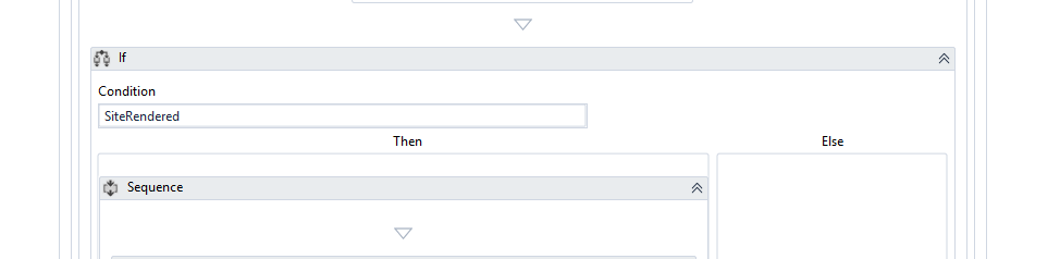

I have shared the workflow with everyone at the beginning.
Make sure you do not make any changes to the logic in the workflow.
I have already testetd every component. The problem lies only at the end where I have to make a selection from the drop down box after the logic is resolved.
