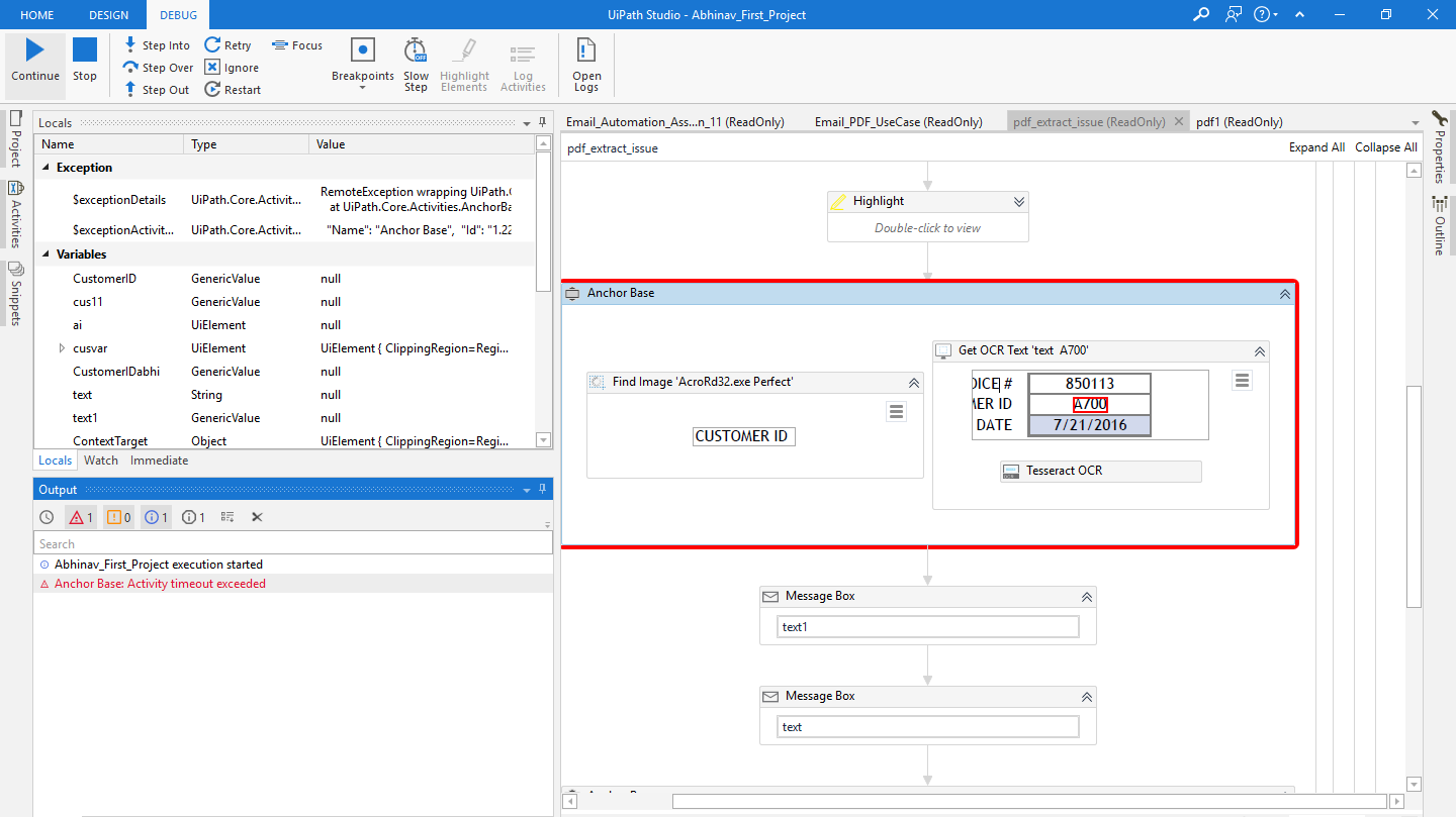

I am unable to extract specific element from pdf using adobe reader for opening it.
Can any one help here. Posting this second this.
attaching the xaml file and pdf.
pdf_extract_issue.xaml (16.7 KB)
Session_10_exercise_1_NPO_1_perfect_match.pdf (95.7 KB)

tried anchor base but not working

please see if i am doing this wrong
pdf_extract_issue.xaml (18.0 KB)
I think this issue is due to find image which is being time out.
Could you please try get text with OCR without anchor base?
@Deepak94
I think the issue is with actin activity not with anchor.
Because i used find image and find element activity to find customer id text and used highlight then i am able to see that…
but i tried with what you suggested having find element as anchor then searching the element
still not working
pdf_extract_issue.xaml (7.9 KB)
