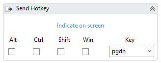

Hi @Gaurav_Bhalla in the send hotkey activity select pgdn
Is this what you’re using to send the command (obviously with your appropriate window “indicated”)?
