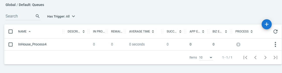

I am trying to solve assignment 2 of level 3 RPA developer certification.
In the dispatcher part of the level, I need to add transactions to the queue “InHouse_Process4” created in the orchestrator.
However, I find that despite many attempts the queue item does not get updated with transactions. It shows “0” items.
I restarted the orchestrator, deleted and re-created the queue.
Is there any way this can be solved?

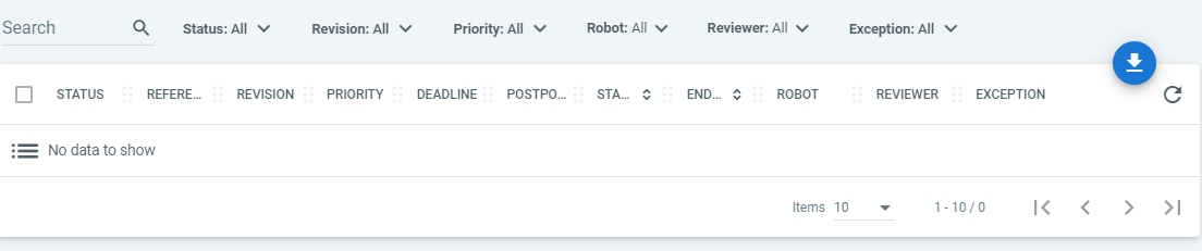

Hello, @kaivalya03
Sometimes Orchestrator isn’t showing items in the main menu.
Did you check the View Transactions tab? If you see Queue Items there, it means everything fine - Transactions are uploaded.

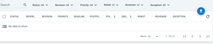

@Vish2148 Please find attached the screenshot of the errors.
@Sergey_Petrenko, I checked the transaction list, it does not show any items in it.
