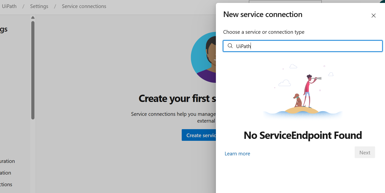

Hi all,
I tried to connect Azure DevOps to UiPath Orchestrator using Service connections, but I did not find it in Service connections.
Any help would be appreciated.
Hi all,
Please follow the link for Azure DevOps service connect document from UiPath
This might help you to establish your connection.
Can you try installing the latest (5.0.9556807) UiPath Integration for Azure DevOps extension from here and retry?
Make sure that the extension is installed on the correct Azure DevOps organization, and you signed in on the correct Azure DevOps organization.
