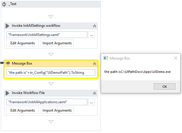

Im stepping through, made a message box to verify the variable in_Config its correct going from InvokeAllSettings.xaml to InitAllApplications.xaml.

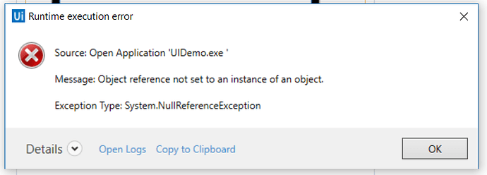

As soon as the workflow InitAllApplications.xaml kicks off. I get this:

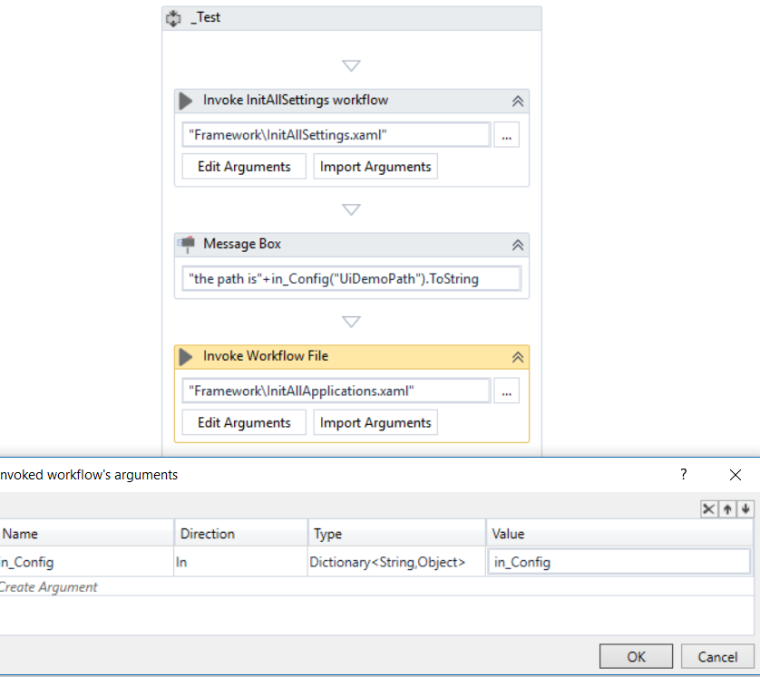

How do I pass the variable I guess is the question?
Thanks in advance.
I had to pass the variable to the argument. Since they were named the same it was messing me up.
Lesson learned. Thanks for pointing me in a direction.
You got it! Best practice would be to use the directions as prefix in the Argument names only and not the variables. Naming the variables and Arguments the same will definitely lead a longer troubleshooting time.
