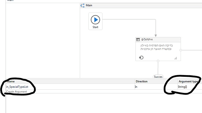

  1. I have a project with an argument (string), but for some reason when I publish the process, my orchestrator doesn’t recognize the argument so I can’t insert the values from the orchestrator, the argument is in the main (it’s a State machine, and the argument is in the main sequence)

this is the main process inside the project, as u see there is an argument
and also this a string (it’s not a problem right?)

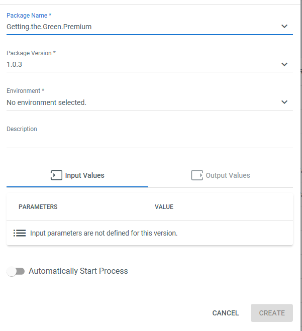

and this is the process after I published I tried to upload it with the arguments but as u can see, there is no arguments in the “Input values”

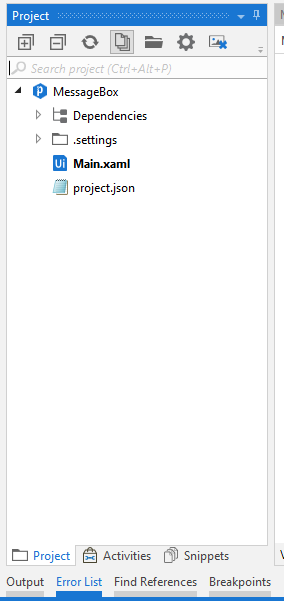

@dlichtenstadt Can you show us the Screenshot of the Project Panel?
Important!
Any type of In argument can be used, yet please keep in mind that only primitives are validated by Orchestrator.
what do u mean primitives and validated?
It’s from the page linked above, not my words :slight_smile:
In other words, Orchestrator will accept only few types of data type (liste in link below) and Array is not one of them.
I’m coming back to my answer: serialiaze your data to allow passing them to the orchestrator.
EDIT: primitive data types and not just primitive types, obviously:

@dlichtenstadt This kind of Panel , Just wanted to Check if the Main is really a Main :sweat_smile:
Capture
U were right
it wasn’t the main, when I changed it to be the main I saw the in_argument in the process page.
