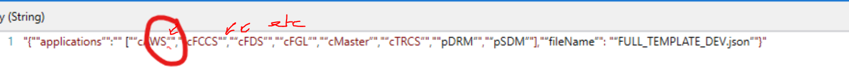

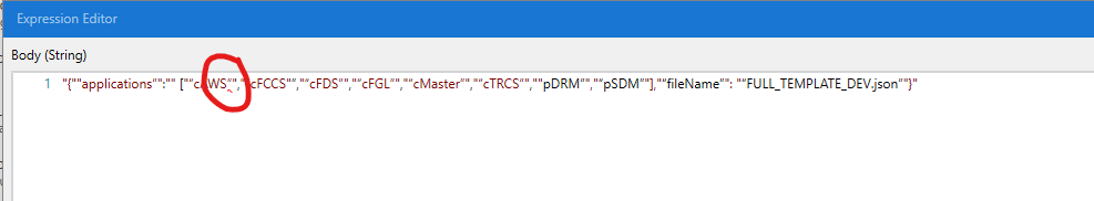

I’ve managed to add the Body…
In the circle there is a red mark. If you roll the mouse pointer over it show the message “End of statement expected”
“{”“applications””:“” [““cAWS”“,”“cFCCS"”,““cFDS””,““cFGL””,““cMaster””,““cTRCS””,““pDRM””,”“pSDM”“],”“fileName”“: ““FULL_TEMPLATE_DEV.json””}”

ensure that all inverted doublequotes are replaced / manually corrected to doublequotes of the type: "
Thank you for your response
The body now looks good with no errors, but unfortunately it’s still failing with the error below…
