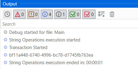

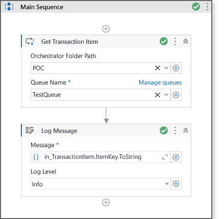

Hi @Nisha_K21
Transaction ID is a unique identifier used to track and manage individual transactions within a process
TransactionItem.Itemkey.ToString
You can get the Transaction Id with this.
Transactionitem.ItemKey.ToString
Why it is used?
You can use this to get specific transaction item through API
