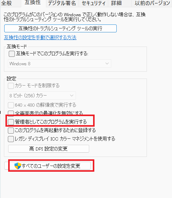

■ Steps
  1. Open the application to be operated on.
  2. Right-click on the target application process from the Task Manager.
  3. Click on “Open file location.”
  4. Right-click on the target .exe.
  5. Click on Properties > Compatibility.
  6. Check “Run this program as an administrator.”
  7. Also check the same on “Change settings for all users.”
