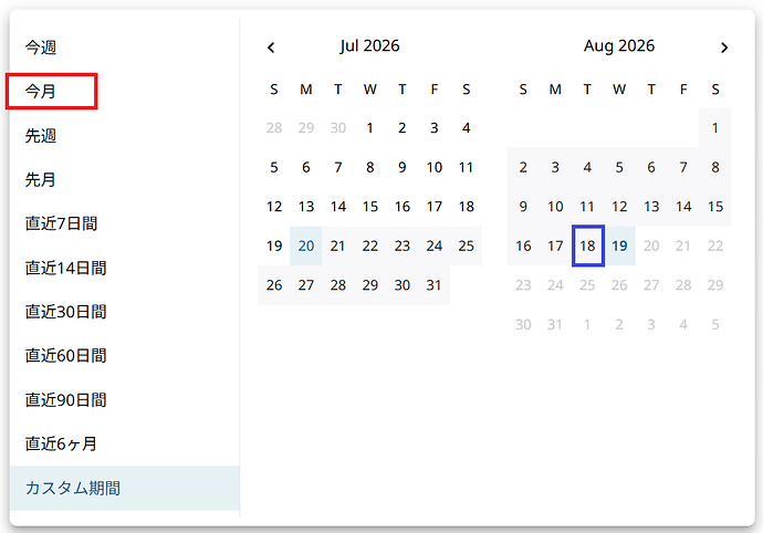

When I click a certain element on the page displayed in Chrome, the screen below appears, and I am constructing a flow to click the date from yesterday (the blue-bordered part as an example).
During execution in Studio or when running a job with the execution environment screen displayed, it clicks the blue-bordered part as expected without any issues. However, for some reason, when executing in the background on the server (running on a virtual machine), it ends up clicking the part outlined in red.
Even with strict selectors, the situation does not change. If there were an error stating that the element could not be found, that would be one thing, but it’s confusing that it ends up selecting a different element instead. If anyone knows a solution, please let me know!

I have the video recording of the relevant workflow enabled in Orchestrator, so I can see what’s happening on the virtual machine, but ideally, the area in the blue frame should become active when it’s clicked, and then it proceeds to the next flow while the area in the red frame is clicked.

Even though the intended click target is displayed on the screen,
it is not selected, and for some reason, a different element, the red-bordered section, is selected instead.

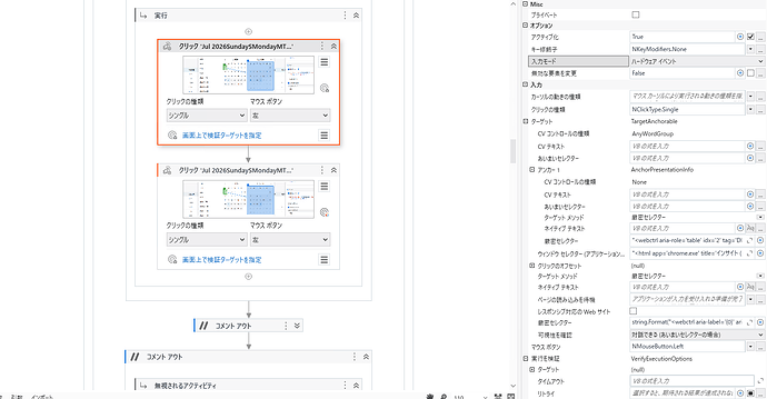

For reference, I will share the property settings for the click in question.

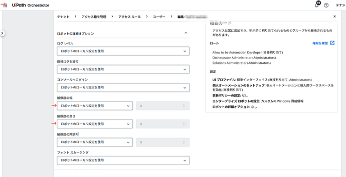

I found out that the resolution can be set in the OC robot settings, and after making that adjustment, the issue was resolved, and it began operating as expected! Thank you very much, Yoichi and Monali_Vekariya, for your guidance!! :smiling_face_with_three_hearts:
Manage tenant - access rights → Click “Edit” at the far right of the relevant user’s row → There is a resolution setting within the enterprise settings, so it might be good to change it here.
As soon as I changed this setting, it was resolved!
