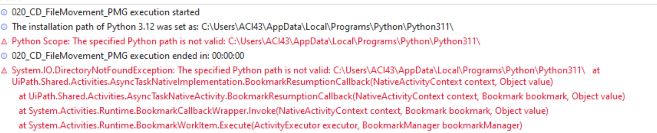

The specified Python path is not valid in uipath
Hello, I’m getting the above error when trying to run python script in studio. Below are my specs:
  • studio version 2023.4.7
  • python package 1.8.2
  • python version 3.11.5
i tried to use the forum’s other posts with no success. Here’s what i’ve done:
  • i’ve put both file path’s into the python scope. both have given me the same error
  • i’ve tried right clicking the program to find folder location and get different path from cmd but that doesn’t work either. C:\ProgramData\Microsoft\Windows\Start Menu\Programs\Python 3.11
  • i’ve tried leaving off “python.exe” as suggested in another forum and when i run file, nothing happens at all. studio freezes

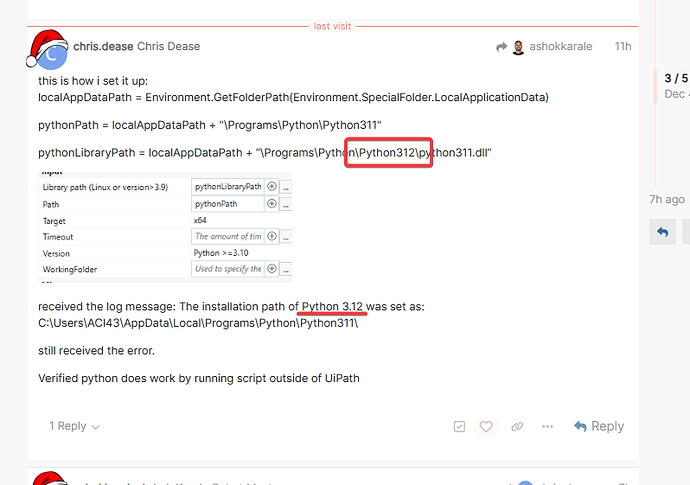

this is how i set it up:
localAppDataPath = Environment.GetFolderPath(Environment.SpecialFolder.LocalApplicationData)
pythonPath = localAppDataPath + "\Programs\Python\Python311"
pythonLibraryPath = localAppDataPath + “\Programs\Python\Python312\python311.dll”
received the log message: The installation path of Python 3.12 was set as: C:\Users\ACI43\AppData\Local\Programs\Python\Python311\
still received the error.

Hey @chris.dease
Just a sanity check, in case you copy pasted the content above. Please note the discrepancy:
i did use 311. i just copied the log message from the documentation
i changed from 312 to 311 and still same result
