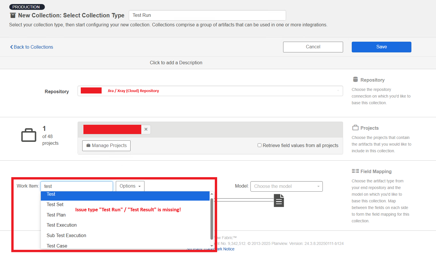

I am having trouble setting up our test synchronisation between UiPath Test Manager (on prem) and Xray / Jira (Cloud).

I can’t integrate different models
I can’t select Xray’s issue type “Test run” and so I can’t add it to a collection
I can’t select Xray’s issue type “Test Set” as a container AND I can’t select Test Manager’s object type “Test Set” as a Work item
Is there someone who has successfully integrated “Tests”, “Test Executions”, “Test Sets” and “Test Runs” between Test Manager and Xray / Jira?
I’d appreciate any help!
By now, we could only integrate the issue type Test.
→ The main problem of my issue is setting up the Xray Test Run collection(!).
Problem solved. The Xray Client ID & Secret weren’t valid anymore.
I guess they have been saved wrong when I saved the repository configuration to change a different field (like Attachment URL). So when you change anything in the configuration, make sure to enter the Client ID and Secret again
