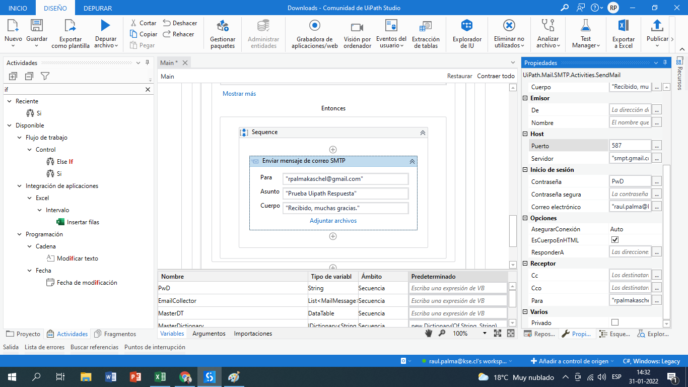

Hello everyone, im facing a problem with unknown host, i have tried all the combinations i could find but none work, this is sending an email from raul.palma@kse.cl to rpalmakaschel@gmail.com
but it isn’t working
I mention that secure apps is On in sender email
here are some pictures:
thanks in advance!

Change your smtp host at the right side of the properties panel, there is some spelling mistake at the first screenshot you write it as smpt instead of smtp try with @Palaniyappan feedback also. Make a try may be its work. Happy mail automation.

Thank you very much, indeed it was a syntax error, thank you for that!
