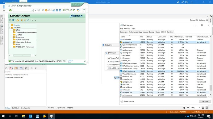

Second, if this doesn’t work, please use Task Manager in elevated mode (Run As Administrator) and show us the information about Username, Elevated Mode and UAC Virtualization of all UiPath processes, including UiPath.Executor, and saplogon.exe, like in the screenshot below:

I have provide both the working and non working machine snapshots.

P.S. I suspect that the workflow runs fine Unattended because the robot process is not elevated in this scenario. Also, there are some limitations in using SAPGUI Scripting if saplogon.exe runs elevated.

We have elevated permissions for UiPath to upgrade the existing version of Studio and Robot on any VM within our enterprise network. So I am unable to launch Studio without elevated privileges.
That may also force SAP to launch with elevated privileges, because when we launch SAP manually(by clicking SAP icon) it opens without elevated privileges (“Elevated” column in Task Manager should show “No”).
