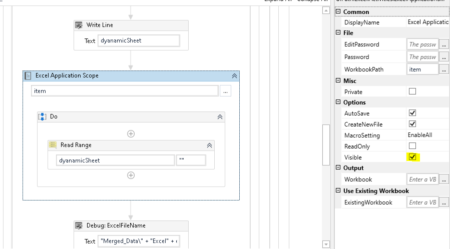

when I executed individulay I can see each excel is opening, extract the data, open the template and feed into it. so I can see everything on the screen. Now I want to see everything on the screen only.
But when i invoked these two workflow, and run with f6 then it doesn’t show me anything.
yes you are right we would get them in foreground for sure
our process was running in background as the VISIBLE property was disabled
kindly check with that property once
It’s visible for all bro.
If I run each workflow individual then it show, But when I run the whole process it’s doesn’t show me. Sometime it show me sometime not. But the process is working fine. What is the issue.
shall I kill the Excel before executing the whole process or any other changes you want me to do. So that whenever I run the main process I can see the all activities on foreground.
How much time it takes to process the excel in the Invoked workflow @balkishan? If the process is running in the background already (only one time), then it will process in the background itself.
Kindly try that once pls
Usually have a kill process activity on the very beginning of the project that kills all the application that we are going to use along the sequence
We have only one excel process na, which is EXCEL
Right me if I am wrong. Before executing the complete process I already used kill EXCEL. But still it’s executing in the background.
I used KILL EXCEL before running the whole project.
Killing all process in the sense, kill all the excel processes @balkishan
Sometimes, we will have atleast 6 to 7 processes running for a single excel in the task manager. so I asked you to try after killing all the excel processes. and one more thing is If the process time is less than 3 seconds, it will just give a blink screen and closes the excel.
Add a delay before excel application scope of around three seconds and try once
As o say you were able to see sometimes and sometimes not, it must be due process speed
