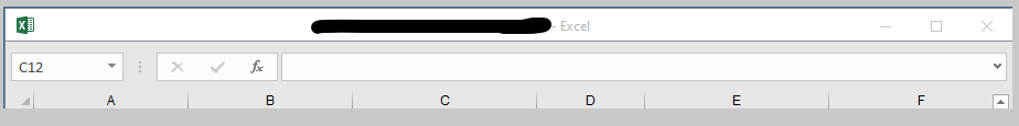

I tried to separate this step from the rest of the steps in Excel. I used a Use App/Browser activity, and set it up for the robot to click the “Refresh All” button to refresh the data connections. However, when the robot opens the file in Excel, none of the buttons in the ribbon are present to click!
Any idea why this would be the case?
I think I may have found the issue. Would the Refresh Excel Data Connections activity not work because of this below?
Screenshot 2022-09-19 103951
Correct. I just completed a very similar automation, and I had to have it click the Enable Content button. FYI using Check App State to look for the refreshing message at the bottom left of the Excel window to disappear, worked well.
Thanks for the confirmation. I added the various Click activities that I needed to, but now Excel fails to respond after the Refresh… I just get “Not Responding,” and eventually have to restart Excel. Of course, nothing has been saved at that point, so the Refresh effectively did not occur. Fun stuff. :upside_down_face:
