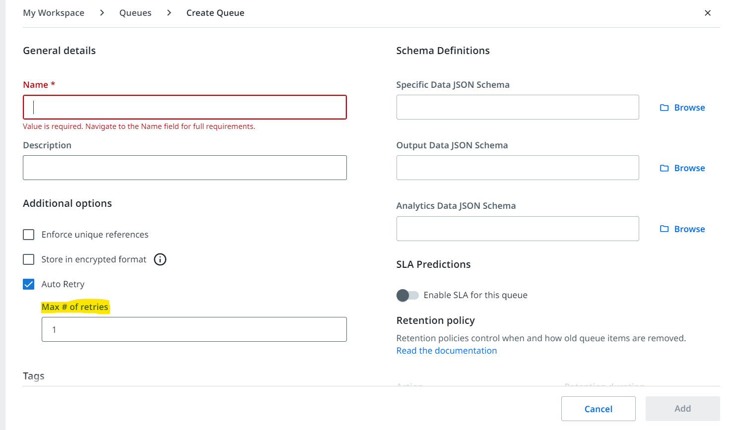

When you are creating the queue you can provide the Max of retries in the Orchestrator.
Check the below image for better understanding.
Hope it helps!!
