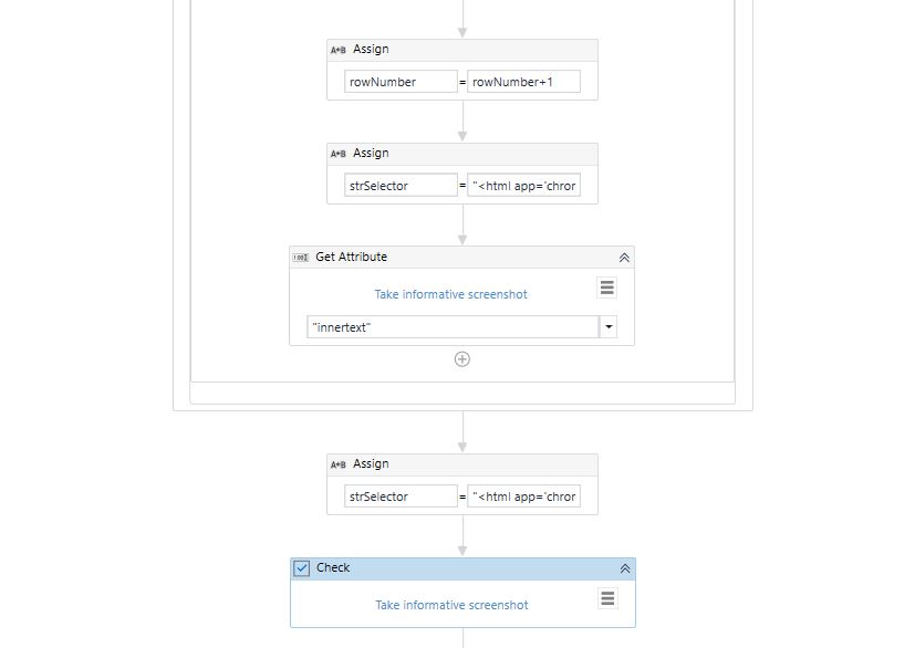

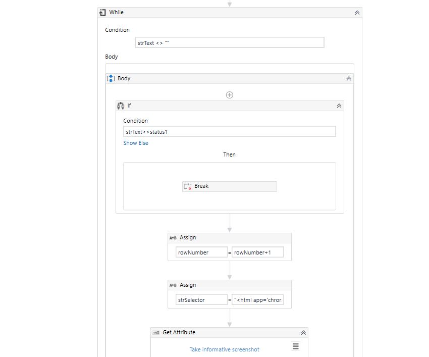

thank you, I used UiExplorer to identify the columns. Also used help from this link for using Assign and Get Attribute but the checkbox condition in the while loop is not working - the difference between this sample and my work that I have to select multiple rows: Enabling a checkbox based on text - #7 by Andrew_Callaghan
This is what I have done. But its still not working
I tried putting in a opposite if condition, and put the checkbox within if condition, but didnt execute.

  2. I have tried putting an = sign for if condition, but its not working. that being said, since I am breaking if the condition is met, shouldn’t it be “not equal to” for it to continue? note that I have to check all the checkboxes that meet the requirement.

Please try these,
  1. Take the check activity and assign activity before that and put that on the then part of if activity.
  2. Condition for if activity is strText = Status1
  3. Delete the break activity as we don’t to need to break the loop.
  4. If check activity won’t work replace it with the click activity with the same selector.
  5. Put a message box and pass strSelector and check if the row number is incrementing correctly.
And don’t use idx if it’s more that 1.
Thanks
Hi @prasath_S thank you the program has started ticking checkboxes but its skipping some boxes (first 2 and then 5 in the middle)
I made the changes you asked, caught another error in my code (after the rowNumber editor +1, my selector code was incorrect).
Now the only concern is that it selects all of them where the condition is met.

The error that I mentioned is resolved. There are 21 rows in total (all with same status “ammended by origin”), the count (using message box) only goes to 17 by skipping 4 rows in the middle (not the 4th, but 4 rows). For the first 2 rows, while it counts them but only starts checking from row 3.
Below is the error, this is probably because it does not have more rows to go to, i will manage this using break in else. do you think that will solve it?
This is whats within my while loop.
