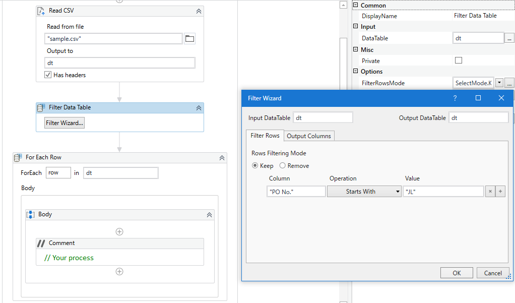

I’ m not sure if loop is correct when you have multiple records. So instead you can first try by
reading csv
Filter datatable with pl.no only starts with JL and in output you can have the required columns alone like pl.no , describ.

Can you try to use FilterDataTable activity as the following?

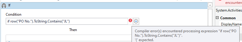

Hi @lakshman ,
When I tried yours, it’s returning an error.
@RojemMolina
Remove If from that expression in If activity.
