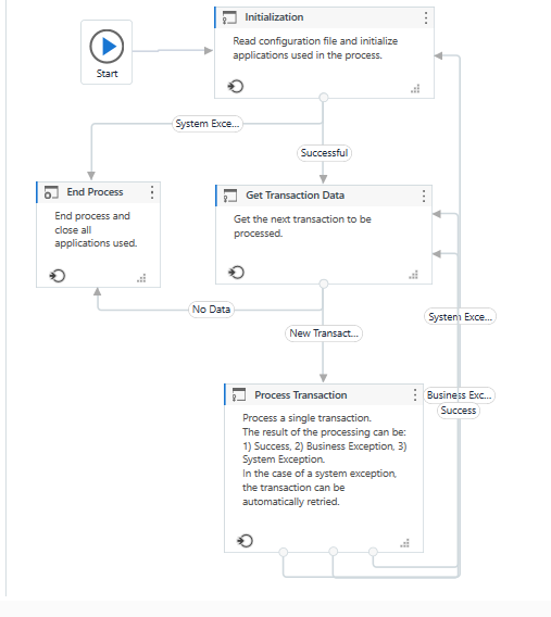

  1. You can use REF
  2. Single ref should be enough
  3. Change the transaction type to mailmessage..so that you can directly iterate over emails
  4. In process state check your attachments and read the data create the datatable
  5. In the end process have the logic to open the application and wrote whole data at once
  6. Then next activity would be to send the report back
As in application there is no separate data input for each email this should suffice

I have started development of this bot using single reframework and completed the bot but while running the bot, when bot is compiling getting below errors and bot is not running even i have already converted and there is no any queueitem variable type:
please see below and provide appropriate solution for this.

Sorry my bad! There error is occurring because of datatype of TransactionItem or out_TransactionItem variable/arguments. Check them and you should be good.

Hi @Mohammad_Imran
You need to change the argument type in the following workflows:
  • GetTransactionData.xaml
  • Process.xaml
  • SetTransactionStatus.xaml
  • Main.xaml
@Mohammad_Imran
Use ctrl+f search for variable name change every where
After that you have to click on import arguments for each xaml where it is invoked and then it would reflect
@Mohammad_Imran
It will be there, go through all the xamls
