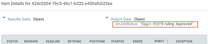

We will have to request this feature. It seems to be impossible right now.
I will be making a work-around and put status details inside the job as item data. However it will be extra work for people to validate the queue. They will have to open each job individually - or exporting and then checking.
@jakelewis18
Workaround: when setting the status of a job with uipath.core.activities.settransactionstatus add a new string variable with the result.
One thing to note is that the queue exports only contain the item status (so failed,in progress, success, etc) and then another column for the level of failure (so business or application) If you put any specific reason for the success or failure it is not exported.
So if you want to view the reason in the queue, you can, but exporting as a report is not so useful. The other thing is that the data fields come down as one cell per transaction so you will need to parse this out to other cells first of all. (Entirely possible using mid and a variety of finds)
Thanks
I agree, it is not very useful. I don’t like the extra parsing burden. I hope we can get additional data fields and filtering options on the queues/transactions page of Orchestrator.
