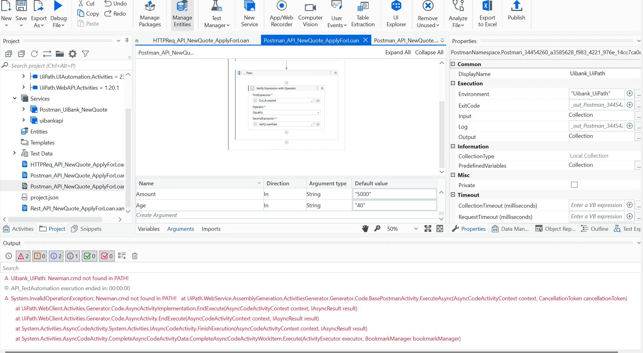

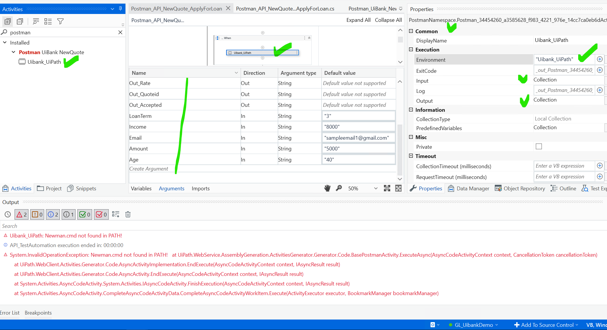

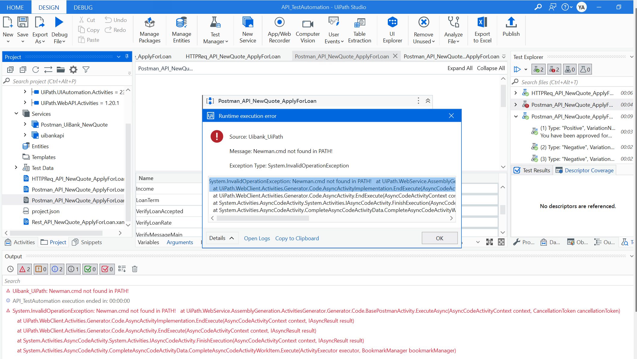

With Postman for API testing - I am receiving this error in Studio, how can I resolve this? tried checking out with the documentation but nothing like the error is mentioned hence looking for advices from experts. Thank you!
Hey @Yeafi_Awal, you require Newman. See documentation.
Newman is the command line tool for Postman, required for running Postman activities. You can find installation instructions on the Postman website. Once Newman is installed, UiPath Studio (and the robots) will search for it in the directories listed in the Path environment variable. By default, Newman installs in the npm global folder (%AppData%/Roaming/npm), though you can opt to install it in a different folder. Regardless of location, ensure the installation folder is included in the Path environment variable.
Best, Emerald.

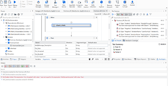

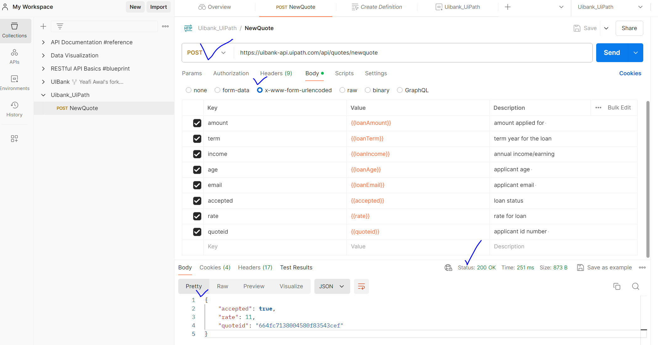

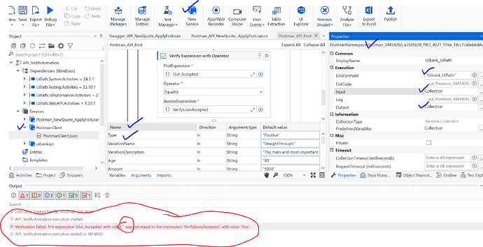

Hi! So I have been trying to resolve this Postman Issue for long time now, finally it is not throwing the Newman error but the below error is thrown for validation where as this validation passes in Post request with Swagger file and HTTP request - so I am preparing three cases - in 3 different method for POST rest API call with 4 data variation NewQoute - and only the Postman is in UiPath is failing to validate whereas the call passes in Postman - collection and environment -
Any advice would really appreciate… can’t resolve this particular Postman till now.
