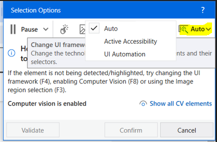

Use Check app state activity to indicate that Popup, in target appear block use click activity
When using click activity try to change UI Framework(F4)
