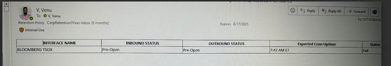

Here is my requirement- I am validating 50 interfaces from a desktop application. Every minute i will be doing data scrapping and the output will be stored in “ExtractDataTable” datatable variable.
Suppose if any interface does not come up after 5min of its actual up time. Bot will be sending email alert like below. The output of failed interfaces will be storing in “failed_interfaces_DT” datatable variable.
now here comes the problem-
at 6th minute - if any interface doesn’t come up. Bot will be sending email attached below.
at 7th minute- interface will come up and it got recovered.
I need to send an email saying 'Interface got recovred" during 7th minute.
