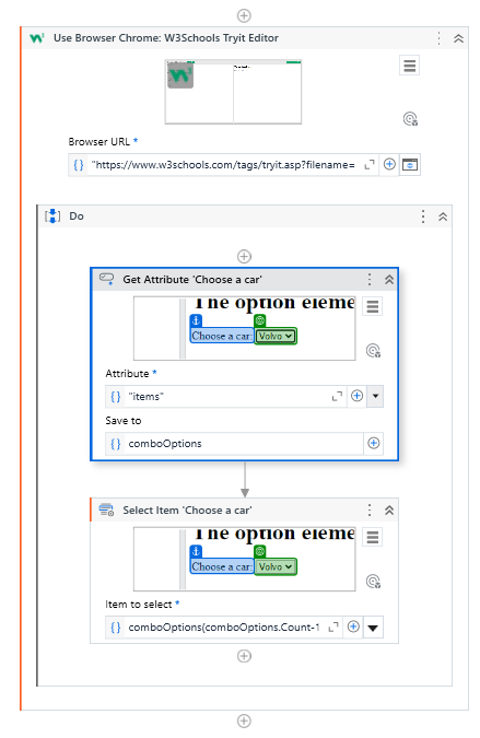

Use this Get Attribute activity to get all the options within the combo box
Select Item // Use the ‘Select Item’ activity to select the last item from the combo box
Item: comboOptions(comboOptions.Count - 1) // Select the last item
