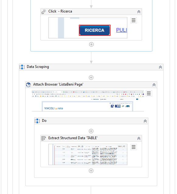

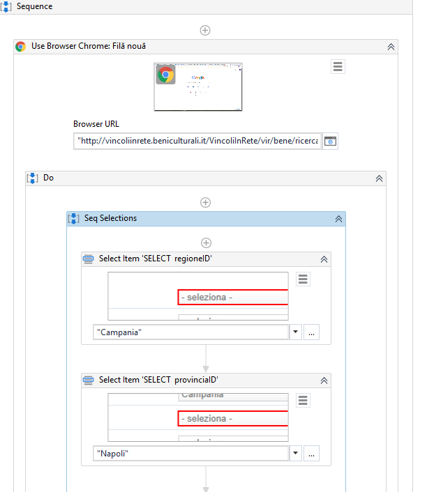

It is just an idea, which might be much faster than clicking on the “lens”.
Complete the combo box from here: http://vincoliinrete.beniculturali.it/VincoliInRete/vir/bene/ricercabeni
Click Ricerca
Use data scraping to get the entire table as a datatable
Use For each row

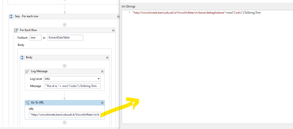

Inside for each row, add the logic to navigate to specific item, since when you click on the lens it will open a new page that have at the end the Codici number.
So here you can craft your URL like:
“http://vincoliinrete.beniculturali.it/VincoliInRete/vir/bene/dettagliobene ”+ row(“Codici”).tostring.trim
For first item will be:
http://vincoliinrete.beniculturali.it/VincoliInRete/vir/bene/dettagliobene125866

Hello @Iron_Man_XXX ,
You can find below a very short/quick flow that navigate to the link you mentioned, select specific options than creates a data table and navigate after that to each url from data table.
Than, you can put your login in the For each row and complete/extract information from those pages.
