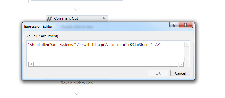

Can you post the selector you are getting in the tmp variable?
As I see, you are passing two single quotes (') at two places , please try by sending one single quote
Good morning @HareeshMR
Please check and let me know which single quotes.
“<html title=‘Yardi Systems,*’/
<webctrl tag=‘A’ aaname='”+B3.ToString+“‘’ />”
passing variable
Error
If you check there, you are sending two single quotes after the variable you are passing @prashantP
May be that will cause the issue
@HareeshMR
I am not which quotes you are talking about.
Can you please highlight ??
@HareeshMR
You are right.
at the end there is one quote is extra – ’”+B3.ToString+"’’
thank you guys…:-:love_you_gesture::love_you_gesture:
