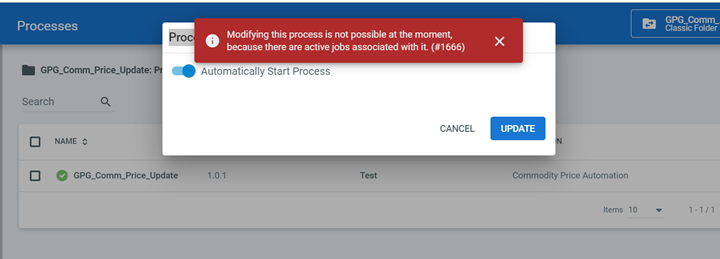

I have a hung job that I can’t delete. It’s stuck in terminating status.
This hung job is preventing me from modifying or creating a new process:
I would like assistance with clearing up this hung job.

When I open the Robot application on the VM it says connected and licensed. When I view the robot in Orchestrator on that VM it shows connected and available. My process is showing as an available process but I see nothing referencing if it’s busy.
When I click on the jobs tab, there are 5 stopped jobs and one stuck on terminating. I’m not able to kill the processes. Do I need to restart the process to attempt to kill the stopped jobs? The job stuck in terminating I can’t do anything with.
I tried that as well. When I restart the jobs stuck on “stopped” they go to pending and don’t change. I review the status of the robot and no change. Then when I kill the pending jobs they go back to “stopped” status.
No change with the process stuck in terminating.
