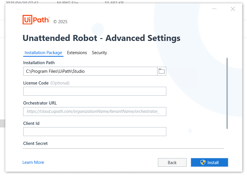

Then your robot is installed in usermode…you would see uipathuserhost.exe that means it cannot run ui automation in background or u attended…so please reinstall the robot in service mode

Make sure the robot is installed in Service Mode.
Note: If you cannot find the UiPath Robot service in Start → services.msc, that means you installed the robot in User Mode.
[image]
To install the robot in Service Mode via the GUI installer UiPathStudio.msi, you will need to select Custom → Install for all users on this computer → Unattended Robot
Reference: Robot - Installing the Robot
To install via command lines, you will need to adapt the example commands which mentions Robot as a Win…

I am currently using trial version of the enterprise edition setup.
when i tried reinstalling it doesnt show me the option to select service mode.

Thank you for your support it worked correctly after reinstalling UiPath as mentioned in the provided article and the issue is now resolved.
Thank you for your comment, I managed to resolve the issue by reinstalling the UiPath robot as for unattended service.
