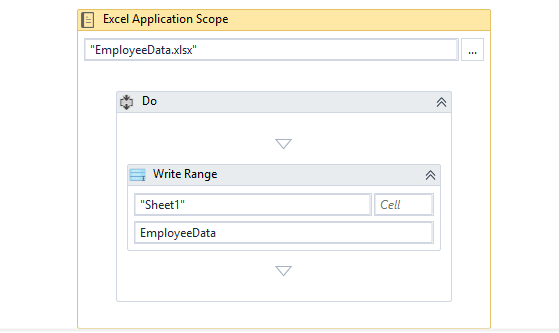

Here i am attaching my workflow.
it is not writing data into excel.
With in the write range within cell property You must specify double quotes like this “”
you are missing those
Hope this may help to solve your issue

Not working after specifying “” also.
Can you share a screenshot of Excel application scope Properties ?
Can you check that Extract Structured Data, is returning the values?
