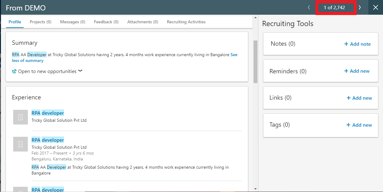

I am trying to get a string from a webpage, but the OCR is not giving the correct result, can anyone help please.
the red highlighted box string is the string that i want to capture

Its not working, as the text element is not getting selected, after the selector is made dynamic.
@Aishwarya_Bhargava Can you send the Screenshot of the Selector by Opening the Selector in UiExplorer and make sure that the Selector is Valid.
@Aishwarya_Bhargava I guess the parentid changes always, You can give parentid=“ember*”
and aaname=“*of*” Check if it highlights the Data that you want to extract.
If this doesn’t work, then we might need to select an Element Which is independent of ParentId and get the parentid from it and then use it in this selector.
its not working
@Aishwarya_Bhargava Can you select the From Demo Bar at the Top and send the Screenshot of it’s Selector in UiExplorer? And Is the “From Demo” always Constant or does it change?
It changes, DEMO changes by a different name when user wants
@Aishwarya_Bhargava Ok. Can the Whole Top Bar be Selected using a Click. If So, then Can you send the Screenshot of it’s Selector in UiExplorer, this might be the last option that i can think of ![]()

Hey, What is the error you’re getting here?
Your expected output is ‘1 of 2742’ ryt?
yes that is what i am expecting
@Aishwarya_Bhargava
If that value is constant, it should work with get text activity as @Pratik_Wavhal has mentioned earlier.
its not a constant value

The below is the 1st img you posted here
From the above img do with 2 ways
- 1st way :-
take aaname parameter as aaname=‘? of*’
take parentid parameter as parentid=‘ember*’
and add one more parameter i.e., css-selector which is mentioned below der in unselected items - 2nd Way
exclude aaname and instead of that take innertext parameter as innertext=‘? of*’
Try above both the ways and let us know whether it works for any of the single way from above
