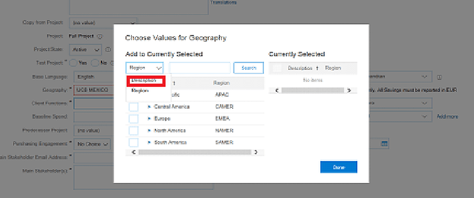

When I tried to do the attached steps in UI path, I’m not able to record the sub screen that comes under ‘search more’. So, I’m struck at that point and couldn’t proceed further. Pls help here

Moreover, we need to select between/Description in the dropdown that appears on the sub page.

Does the selection work on that sub-screen?
Hi Badita,
It is showing “Selector not found Error” while debugging that recording. For that I made some changes using Ui Explorer. But it didn’t work. Please help me out. Thanks in advance.
Mamatha.
So you’re able to recognize elements within that sub-screen, right?
What is the selector?
After that i need to select Description from the list. By default it is Region.
Here UiPath is not able to recognize that Description from the drop down.
Can anyone help me to find the solution?
Hi @MamathaG,
Uipath will not recognize what you have in the dropdown list as you hover and select click it goesoff,
i had previously faced this issue so the solution is select the dropdown and use typeinto and use D and then in the add ons use enter key description gets selected.

Uipath is not able to identify this dropdown
Hi @MamathaG
is it able to find any element in that popup window
or only the dropdown
no, its not identifying any part in sub screen
Hi @MamathaG ,
then only way is to use citrix recording and try to do it,
Citrix recording is also not working.
Hi there,
have you tried to attached a new window with this automation?
you can use attached activity by dragging and dropping from the activities pane or using the recording option.
Can you please share the XAML file? this is important because most of us don’t have access to Ariba, I tried to see if I can get a demo but couldn’t.
Clicking might not help, try to use send keys activity as @srishsai suggested.
